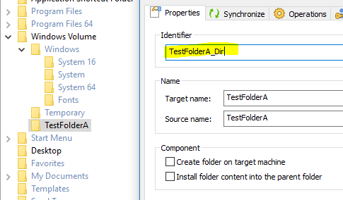

So, I go back into AI and see that the feature directory is set to APPDIR (even though all of it's compoenents are in TestFolderA_Dir). If I click the “…” button and try to select C:\TestFolderA (TestFolderA_Dir), I see:
So, I open up the properties of C:\TesetFolderA and try to change the identifier to all caps, so I can select it for the feature Directory:
However, it doesn’t let me change the identifier. I try changing TestFolderA_Dir to all caps in the table editor, but that doesn’t seem propagate to the feature install directory. So, I open the AIP in notepad++ and change all instances of TestFolderA_Dir to TESTFOLDERA_DIR, and now I can select TESTFOLDERA_DIR for the feature installation directory. At this point, everything seems to work for clean installs. FeatureB now installs to TESTFOLDERA_DIR, and the files are installed to the correct directory.
However, I then run into the following issue. If I perform a clean install and use custom installation paths, during a major upgrade, the custom path for FeatureA (APPDIR) is persisted, but the custom path for FeatureB (TESTFOLDERA_DIR) is not. Not sure if it matters, but I’m displaying the SetupType/Custom Setup dialog during major upgrades, so the user can change the paths if they want to.

Also, why can’t I change the folder identifier to all caps? Having to do it in notepad++ is kind of annoying.

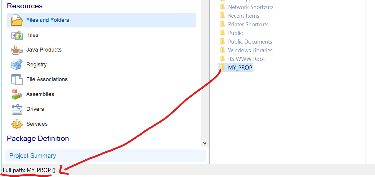

  1. This results in an unorganized list of folders in the "Files and Folders" view. Compare "MyFolder1" with "TESTFOLDER":
When you are looking in the "Files and Folder" view, it's very easy to understand where "MyFolder1" installs to. But, with "TESTFOLDER", you can't easily tell.
  • Regular folders (like "MyFolder1" in the above screenshot) work in all scenarios except major upgrades with custom paths. So, this seems like an unnecessary workaround for that one scenario.
  • APPDIR works, so why don't other folders work? Although, I just found out that APPDIR_64 doesn't (details at the bottom).

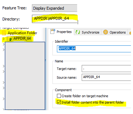

Also, I found a somewhat related issue. I have 32-bit and 64-bit installations in the same project. This means I have APPDIR and APPDIR_64:
APPDIR_64 is set to "Install folder content into the parent folder". And, I have the feature directory (for the 64-bit version of the feature) set to APPDIR_64 (APPDIR\APPDIR_64). After installation (clean install), HKLM\Microsoft\Windows\CurrentVersion\Uninstall\[ProductCode]\InstallLocation is set to the default path of APPDIR_64, instead of the custom path entered by the user on the "Custom Setup" dialog. This seems like a bug, and it causes issues with the paths during upgrades (I believe the installer carried over the path in \InstallLocation during the major upgrade, which is wrong if the user entered a custom path during the clean install). So, I basically had to use the work around mentioned above: save the value of APPDIR_64 to the registry during install, and read it in during major upgrades.

First of all, I would like to start by saying that I do not believe all the additional work is worth just for making the folder structure in the "Files and Folders" page be more intuitive.
If the new developer of the project is confused by that, there are few ways of pointing him in the right direction:
1. when selecting the property based folder, its path is shown in the application
2. in addition to that, notes can be added to your project that can be later viewed by new developers
In what regards the reason behind not being able to modify the "Identifier" (especially with only uppercase characters) is to avoid the desynchronization of the tree-like structure (there are some strange scenarios when this happens). Long story short, it is not a good practice to have two directories with a child relationship between them have their identifiers written in all caps letters. This is the reason why, when creating a property based folder, it is automatically added at the bottom, as a standalone element (not as a child element).
Of course, this can be "hacked" around by either modifying the XML file or by changing the identifier from the "Table Editor" page. However, I would advise against it.

Thank you. Also, since this is the case, please reconsider the issue I described earlier. I've attached an example project that replicates the issue:
  • Build "Install64".
  • Run the install, choose a custom path, and finish the install.
  • Notice that HKEY_LOCAL_MACHINE\SOFTWARE\Microsoft\Windows\CurrentVersion\Uninstall\<product code>\InstallLocation is set to the default path instead of the custom path.
  • Rebuild the installer with a newer version number and product code (to force a major upgrade)
  • Perform another custom install and notice that the default install path is being used instead of the custom install path that your application was installed to.
In the project file, it's worth noting:
  • I have a 64-bit application directory folder (APPDIR_64_DIR) that is set to "Install folder content into the parent folder" (which is APPDIR).
  • The install path of the 64bit feature is set to APPDIR\APPDIR_64.
If you change the feature install path to APPDIR, this fixes the issue for major upgrades. However, it breaks minor upgrades. If you then perform a minor upgrade, it will change HKEY_LOCAL_MACHINE\SOFTWARE\Microsoft\Windows\CurrentVersion\Uninstall\<product code>\InstallLocation to the default location of APPDIR, instead of the custom path you used.
So, it's not clear to me if I'm supposed to set the feature install directories to the parent folder or the child folder when using the "Install folder content into the parent folder" option. Either way seems to result in a bug.
Thanks.
AITest.zip
(35.15 KiB) Downloaded 475 times
Posts: 7794
Re: Custom Install Paths and Major Upgrades
First of all, thank you for the provided files.
I have tested this and I could indeed replicate the behavior.
First of all, please keep in mind that the InstallLocation registry entry refers to the APPDIR location, which most probably you did not modify in the CustomizeDlg dialog.
Also, another thing to be kept in mind here is that the upgrade process can not know about the value of your property if the property is not persistent.
To fix this, you can proceed as it follows:
- first of all, please go to "Files and Folders" page and uncheck the "Install folder content into the parent folder" option
- now please go to "Install Parameters" page and create your property there, as it follows:
Value: whatever value you'd like as the default value (e.g. C:\)
Check the "Set persistent property" option.
Important: Make sure this value is included in the 64-bit build.
Now, during the upgrade, the value from the previous installation should be used.
The above is basically the same as working with property based folders, the only different thing being the folders structure (as it is a child folder for the "Application folder").

Let me ask this. Setting aside the issues of major/minor upgrades for the moment, if I'm using the parent-child folder configuration (which is suggested in the Advanced Installer documentation), what is the "proper" way to set up the folders and feature install path in the attached project (32-bit and 64-bit builds in the same project):
  • Create a child folder with the "Install folder content into the parent folder" selected?
  • Do I make the child folder property/identifier public?
  • For the 64-bit build, do I set the feature install path to the parent (APPDIR) or the child (APPDIR_64 if I make the child property public)?
From my perspective, there appears to be at least one bug here tied to the child-parent configuration of APPDIR, since everything works for the 32-bit build in my test project. If you are going to give the user the ability to support 32-bit and 64-bit installs in the same project via the child-parent folder relationship (along with the "Install folder content into the parent folder" option), then I think you should make it work in all scenarios (major and minor upgrades). What I'm seeing here is that the parent-child feature that Advanced Installer has is not viable for all installation scenarios (major/minor upgrades) that use custom paths.

As long as the property is public (so its value can be passed from Wizard Dialogs Stage to Install Execution Stage), you can make it persistent as I have showcased in my latest thread.
However, APPDIR seems to be a special case.
We made it "special" because, by default (when creating a new AI project), the "Use original installation path when upgrading" option is checked in the "Upgrades" page. However, this does not mean you can not make other folders behave the same.
Yes, this will be needed so the value of the property will be written in the registries (a registry entry is written during the "Install Execution Stage" and only public properties' values are carried over from "Wizard Dialogs Stage" to "Install Execution Stage")
Here, I would advise treating the "APPDIR_64" folder as a standalone folder (not as a child) and making its property persistent as I've showcased in my last thread.
I would suggest a feature/enhancement in a future version of Advanced Installer that addresses this scenario. I think it should be easy (like... clicking-a-check-box-easy) to carry over custom install paths.
As I have previously mentioned, we will improve this so you can change the identifier of your folders to public properties. After being able to do so, you will just need to set the property as persistent (I believe this is "easy" enough).
Hope the explanation helps.
