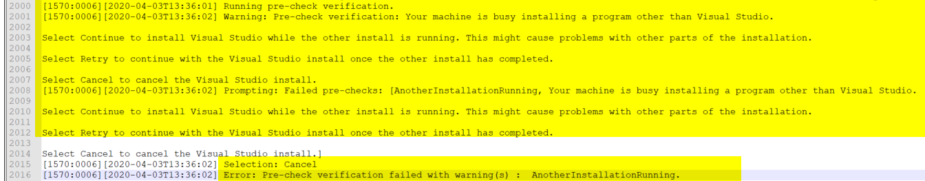

In the logs from the Microsoft Installer I see the following error:
It seems that my own installer is blocking the BuildTools-Installer. Similar to the problem with .NET Framework described here: https://www.advancedinstaller.com/user- ... uestion124

Basically, the setup is failing because there is another installation happening at the same time (as exposed in the log file).

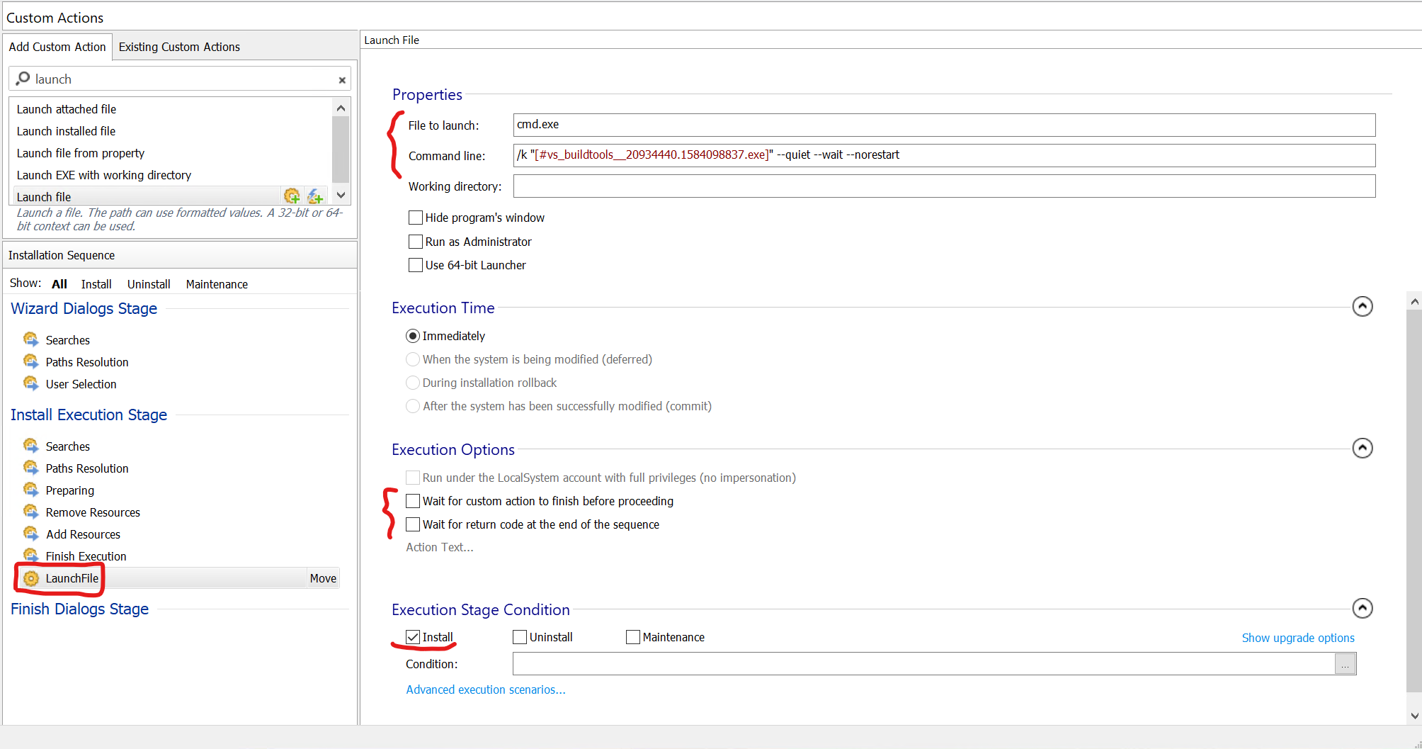

To avoid this, we need to launch the setup asynchronously. To do so:
- please add the setup of your Microsoft Build tools in your project ("Files and Folders" page)
- in "Custom Actions" page, create a launch file custom action that will launch the setup with the required parameters. Here is a screenshot of how I have configured it:
As you can see, the setup is launched at the end of the installation (similar to a post-install prerequisite). One thing to be noted here is the "Wait for custom action to finish before proceeding" option which is unchecked (the custom action is run asynchronously).
Also, I have used the "/k" parameter who launches the cmd and then waits for an input in order to close. I have mostly used this for debugging purposes. In your case, you can use the "/c" parameter instead, which will launch the cmd and the close it (it will not wait for user input).
Also, make sure the path to the executable is encapsulated between quotes, as it may contain spaces. In order to get the property assigned to your executable, in the "Command line" field, simply input "[" and then from the dropdown, select "File..." and then select your executable.

Did you uncheck the "Wait for custom action to finish before proceeding" and "Wait for return code at the end of the sequence" options as showcased in my previous screenshot?
This way, the installer should not be waiting for the custom action to finish, thefore the "another installation is already running" message should not be spawned.
Please make sure the options are unchecked and let me know if everything is working as expected.

Yes, these are unchecked.

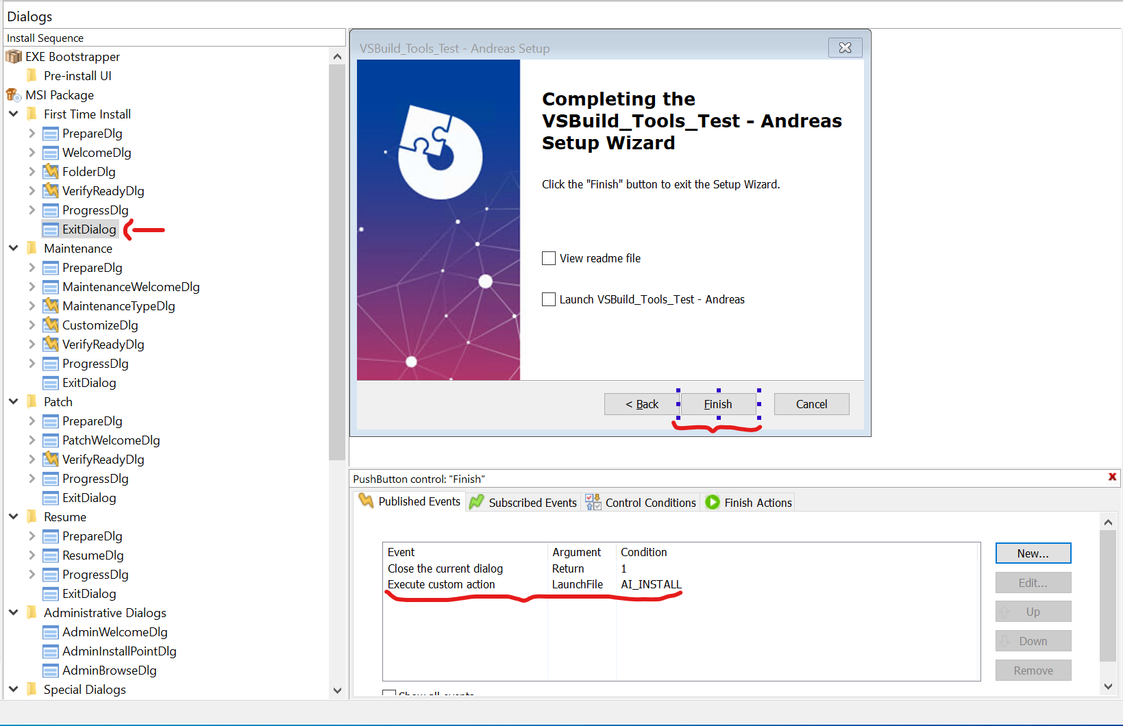

Here is how I've thought we can avoid this:
- first of all, we need to change the sequence of our custom action from "with sequence" to "without sequence". To do so, you can go to "Custom Actions" page --> select your custom action --> right click on it --> "Sequence" --> "Without Sequence".
This will allow us to trigger the custom action from a dialog button instead of it triggering automatically. I've been thinking that we can trigger the custom action when the user presses the "Finish" button so we can be sure that the main process does not interfere with the second installation.
- go to "Dialogs" page --> select "Exit" dialog --> select the "Finish" button --> under "Published Events" add a new event that will execute the custom action.

Re: Microsoft Build Tools Installer fails when running within my Installer
thanks for your reply! I tried your solution with an new Advanced Installer Project. I ran into the same problem.
