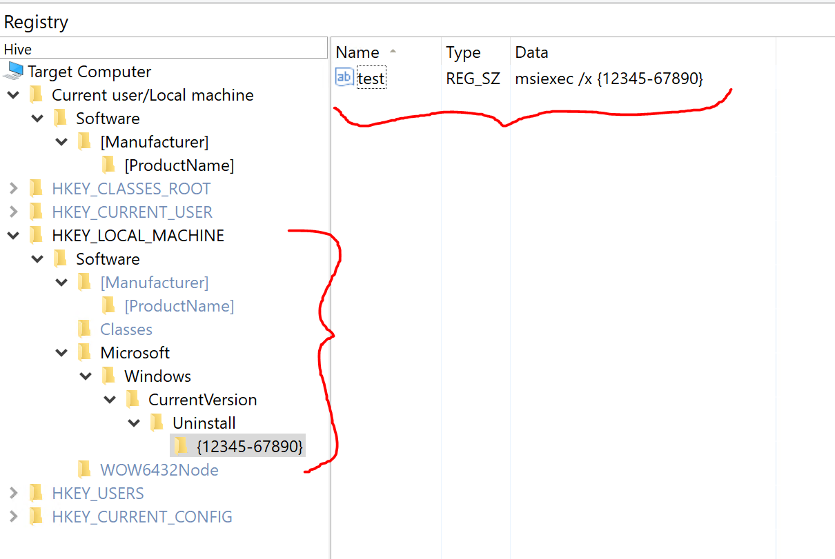

I have tested this right now and everything worked as expected on my end.
Here is the test registry entry that I have created:
Here is how I recreated the registry entry in Advanced Installer:
After installing the setup, I have checked and noticed that the registry entry was correctly changed.
The steps that you mentioned regarding recreating the registry hierarchy in the "Registry" page is not possible IMHO since the product code is dynamic property.
In what regards this, could you please give me some more details about the ProductCode? How is it related to your setup? Depending on how the ProductCode is related to your package, we may find a way to dynamically retrieve its value.
