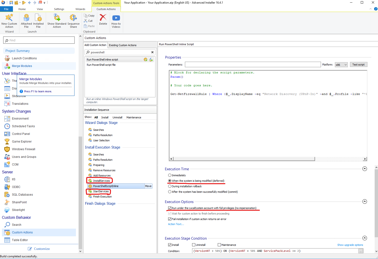

Here is how you can implement that in Advanced Installer:
1. first, you need to disable the option from the "Windows Firewall" page
2. now please go to "Custom Actions" page and add a "Run PowerShell inline script" custom action, with sequence (simply press the "Add custom action with sequence" button which is placed to the right side of the custom action's name).
3. copy paste the code from above. Additionally, set the execution time to "When the system is being modified (deferred)" and also check the "Run under the LocalSystem account with full privileges (no impersonation)" option. Optionally, you can set this action to execute only during Install by unchecking the "Uninstall" and "Maintenance" options from under the "Execution Stage Condition" section.
4. now please right click on any action group from the "Install Execution Stage" --> "Show Standard Action" --> "Add Resources" --> select "InstallServices"
5. please repeat the above step, but now select the "StartServices" action
6. now please schedule your custom action between the two actions mentioned above. To do so, simply drag and drop it.
7. in the end, your custom action should look something similar to this.
