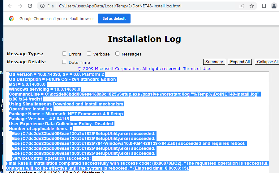

Hi Team,
We have an installer that has .net 4.8 as a pre-install prerequisite.
This is a mandatory prerequisite.
ndp48-x86-x64-allos-enu.exe
During the install, the command line params are-
/passive /norestart /log "%Temp%\DotNET48-Install.log"
We are getting response in the log file as shown in the attached image "Screenshot 2022-08-23 195224.png"
Even though the .net framework is installed successfully, with a pending reboot, the installer is failing.
The installer has install parameters 'Reboot behavior' set as "Prompt for Reboot when required".
Please help us in identifying this as success and not error.

As you can see, that error is given by the prerequisite setup itself, not by your setup. As per my knowledge, .NET Framework indeed requires a reboot after its installation in order for the system to consider it being installed.
This is why the "Conitnue with the main installation even if prerequisite was not installed" is checked by default for this prerequisite.
The above option simply checks the install conditions one more time after the prerequisite is installed. In the case of .NET Framework, this is a registry entry.
Registry entries are updated for .NET Framework only after the system has been rebooted so that would always give an error in your main package if the option would be unchecked.
Please try the approach given by @NovaES and let me know if everything works as expected.
