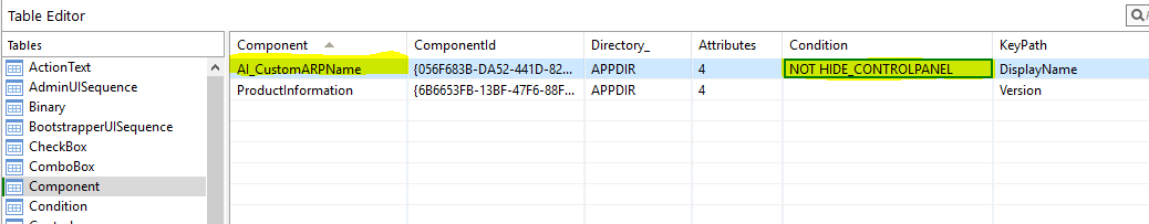

Posts: 4529
Re: ARPSYSTEMCOMPONENT with "Override Windows Installer Program list entry"
Note that the ARPSYSTEMCOMPONENT property is set by default in an installer where you have the Override Windows Installer programs list entry option enabled.
To avoid the application from being displayed in the Control Panel that has the Override Windows Installer programs list entry option enabled, you need to condition the installation of the AI_CustomARPName component.
You can condition the installation of the AI_CustomARPName component, though a property as below:
AI_CustomARPName Table Editor.PNG (15.44 KiB) Viewed 13603 times
When you want to hide the Control Panel entry, you can set the property that you are using to condition application from being displayed in the Control Panel: e.g.
Please let me know if there is anything else I can help you with.
