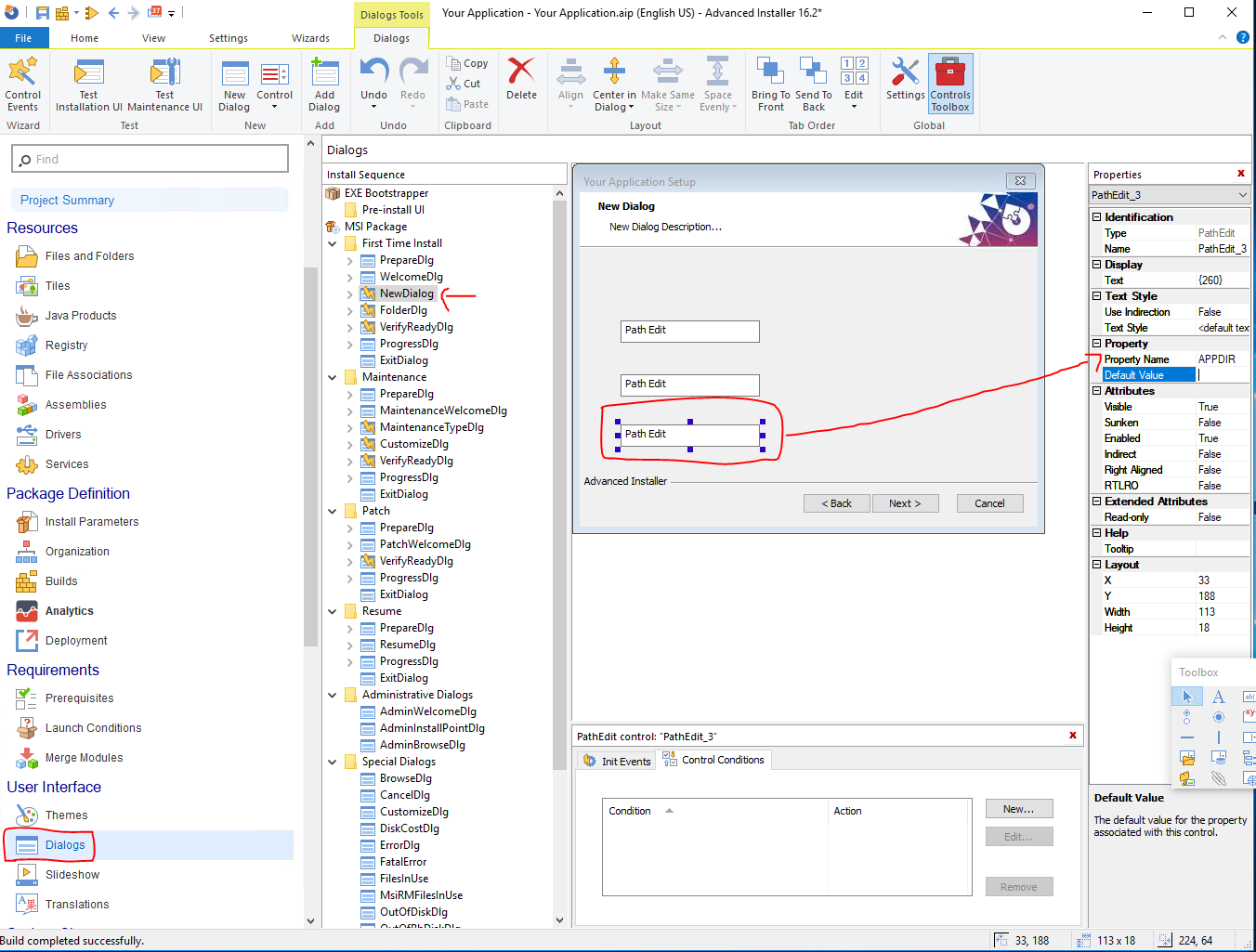

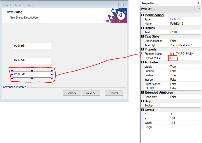

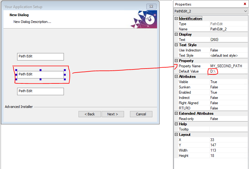

Now, going back to what we have discussed earlier. If on your newly created dialog, you add two Path Edit controls, they will have the property assigned to them set to APPDIR by default:
This means that, when you set one of the Path Edit's default value, all the default values will be changed since they do share the same property.

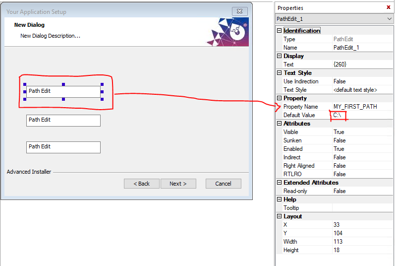

A workaround for this problem would be to change the property assigned to each of your Path Edit controls.
This can be done by going to "Dialogs" page --> select your dialog --> select the Path Edit control --> on the right pane, change the "Property Name" field from APPDIR to anything you desire, for instance: MY_FIRST_PATH.
Accordingly, you can proceed in renaming the property assigned to your other controls.
Here is an example of how all of this can look:

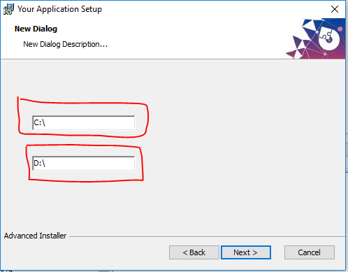

After doing so, upon installation, the dialog should look like this:

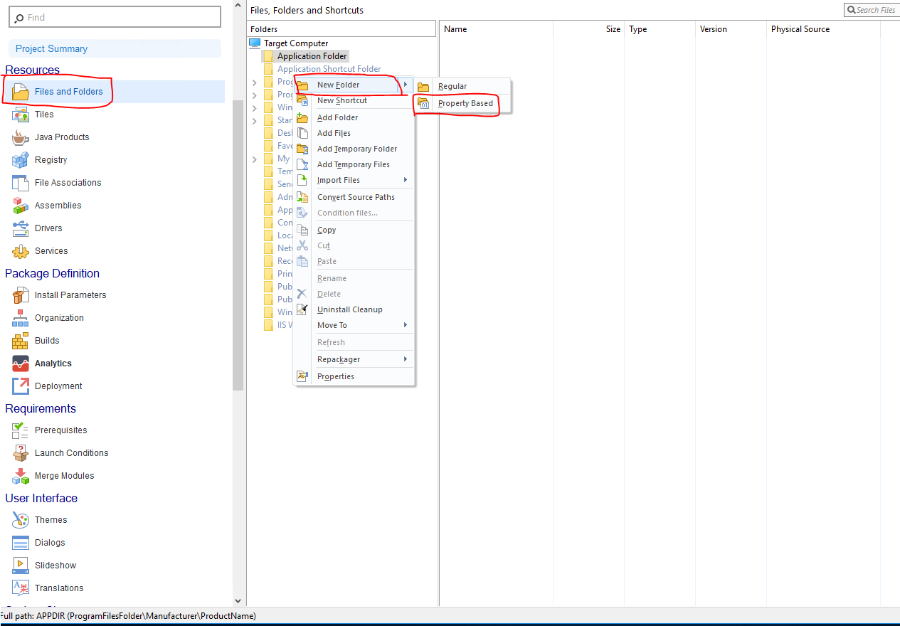

In order to create a property based folder, you can proceed as it follows:
1. go to "Files and Folders" page
2. right click --> "New Folder" --> "Property Based"
After doing so, the "Select a Property" dialog will be spawned, asking you to select the property which should be assigned to your folder. If you expand "User Interface", you will be able to find the earlier created properties there.

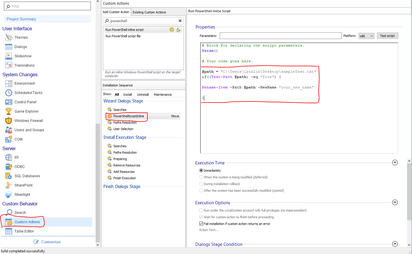

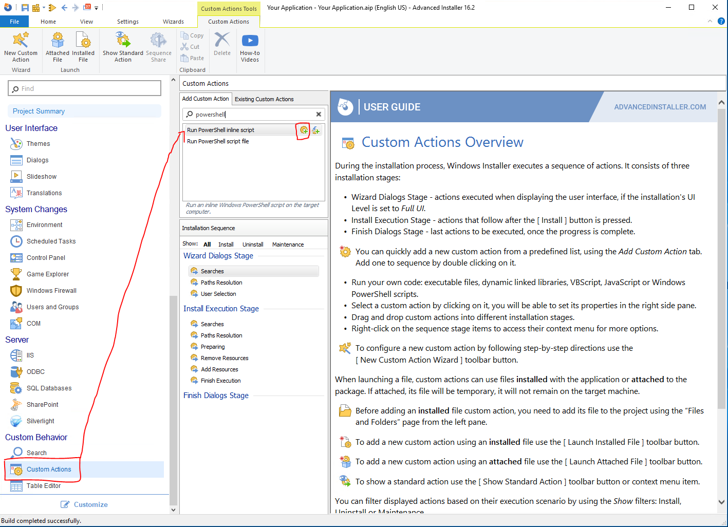

Now that we have created the script, it is time to implement it in Advanced Installer. To do so, please open your project and:
1. go to "Custom Actions" page
2. add a "Run PowerShell inline script" custom action with sequence. In order to add a custom action with sequence, simply press the "Add custom action with sequence" button which is placed to the right side of the custom action's name.
3. now simply copy paste the above code under the "Your code goes here" comment.
4. after doing so, we will need to schedule this custom action to run at the start of the installation. In order to do so, simply schedule it after the "Searches" action group --> "Wizard Dialogs Stage". To do so, simply drag and drop it.
In the end, it should look like this:
